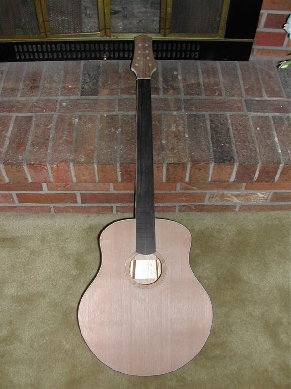

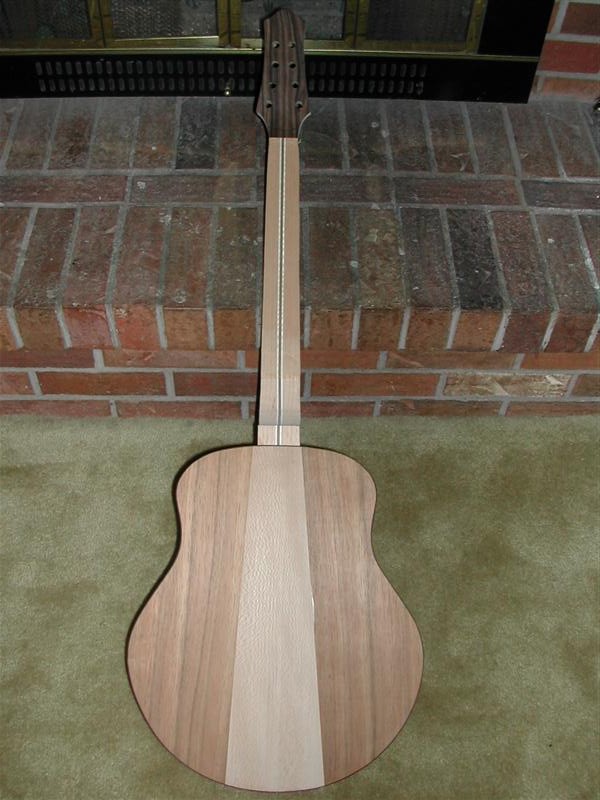

Here's another update on the Bouzouki. I just completed the neck joint and glued the fretboard on. The FB Extension is not glued yet so I can take it apart and finish them seperately. I need to level the fretboard and do the inlays, carve the neck, and fret, then on to the finish. Getting close! Thanks for looking.

Thanks all! I've only played one once before, and that is why I'm building one so I can learn to play it. I like the mandolin, but the neck is too small. The bouzouki is a compromise between a guitar and a mandolin. It has 8 strings (4 courses) and tuned to GDAD. This shape is not the traditional onion on a stick shape, but I like the ability to rest it on your thigh while playing. The traditional teardrop shape seems to slide down your leg why playing in a sitting position.

Mark,
You'll have to take some pics of your progress. Will it be the onion on a stick shape or a guitar shape? I'm using a butt joint with bolt inserts. This is the first time to use this. It is much easier cutting the neck angle, but can be just as difficult fitting the neck.

Thanks Karen, I just hope it doesn't pop like bubble gum when I string it up! I'll be a little late Thurs night, but I'll help you when I get there if Robbie hasn't already. I'll probably be carving my neck Thurs night.
Peter, the scale is 25.4" same as a regular guitar. The nut width is 36mm(1 3/8") and 46mm(1 3/4") at the 12th fret. A little smaller than a steel string, but with 4 course strings, it should equate to a guitar neck. Should be fun to play.

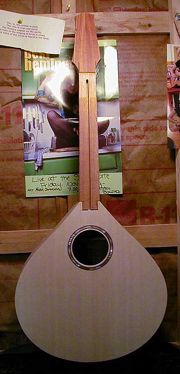

Posts: 575
Ok, here's a picture of the "onion" that I'm working on right now. It's got walnut back and sides, spruce top and mahogany neck. That peghead overlay is cocobolo, and it'll have cocobolo binding and trim.

PostPosted: Fri Apr 21, 2006 3:00 pm
Hurry up, Tracy!
I want to see some finish on that thing.
I think the wood is really gonna "pop" under finish, and I'm especially interested to see how that wedge of sycamore turns out.
